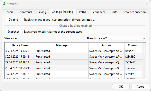

and with version 1.5.7.8. we introduced a new feature called “Change tracking”:
in SweepMe! Pro.
This feature will track all changes in the public SweepMe! folder like settings or customer drivers.
If there is any file lost or corrupted, you can restore an earlier version easily, by right-clicking into an record item in the above list.
Because of the “repository path” in your debug message, it might be related.
In version 1.5.7.9 there was an improvement released that allows to use Change tracking across different OS users.
My recommendation would be to update to 1.5.7.13 or even better go ahead with SweepMe! 1.5.8 that you can install in parallel. Then, check whether it works.
One could also disable the Change tracking to see whether it has an effect, but in general it is a good idea to keep it on.

have you tried to disable “Change Tracking” and see whether it works? It can be done in the Options (menu “File” → “Options” → tab “Change Tracking”)
In the meantime, I will forward the case to my colleague and I will let you know when we have a solution.
