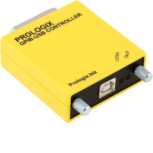

I know a similar adapter from Prologix
that is also controlled via RS-232 and then translates it into GPIB.

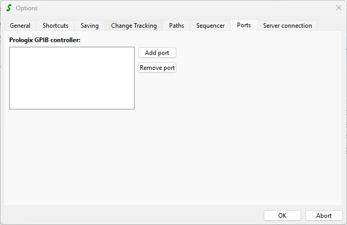

We have added support for these Prologix adapter. The user can go to
menu “File” → “Options” → “Ports”
where one can register a COM port that is then used to display a GPIB resource like
“GPIB::20::Prologix@COM7”

According to this webpage
https://sdfa3.org/david/ar488/commands.html
the command set of the AR488 should be fully compatible with the one of the Prologix adapter.
So, there is a good chance that it just works out of the box.

We indeed have not added all commands that are provided by Prologix, but those that are needed to send and receive messages including changing GPIB addresses. It means that the SweepMe! port manager automatically changes the GPIB address at the Prologix adapter, when multiple instruments are connected to the adapter. We once helped a customer to replace NI GPIB adapter to interface with Keithley 236 or Keithley 2400 and this worked reliably.
If you figure out which commands from the Prologix command set are missing to control your equiment let us know!
