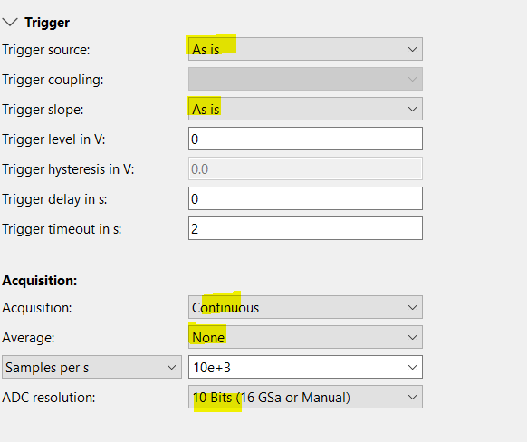

Coming back to your original request regarding the Scope driver, it would be relatively easy to make the following user input fields of the Scope module editable:
Would this be something that helps you to proceed?
In general, we would like to make more input fields “variable” (i.e. supporting parameter syntax) but have not revised all modules right now. We do it on demand or when it is needed in our customer projects. So, it would be not a problem to change it now as it goes in the right direction.

New Scope module version 2025-03-04 is available as testing version.
As described above all relevant dropdown boxes are now editable.
@Christian If everything works for you, we will switch the version to live making it available to everyone. Please log in to download the version in the SweepMe! version manager and let me know if it works.
