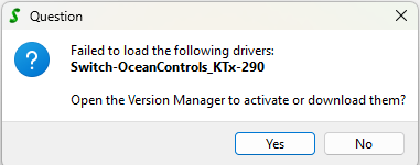

The debug message you receive is printed when a driver cannot be loaded during the loading of a setting. It seems that “Time-delay” and “Sample Height” are detected as missing driver instances. Do I understand you correctly that these are 2 GUI parameters of the KTA-290 instead? As far as I can see from the original Switch-OceanControls_KTx-290 driver, there are no GUI parameters named “Time delay” or “Sample Height”. Did you make any changes to the set and get GUI parameter functions?
Do you receive the warning window that is usually displayed if a required driver is missing to load a setting? Or is there additional output in the debug widget (F2) that denotes why the driver fails to load?

Yes I’ve changed the driver extensively, and have a ‘Device Mode’ GUI parameter. Whichever ‘device mode’ is selected in the setting will be displayed in the debug, not in a pop-up window, as being a missing driver. So the behavior is not what is typically seen for a truly missing device driver.
