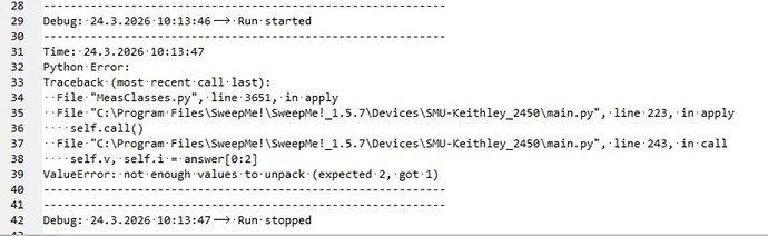

Hi SweepMe Team. I am having problems to run transfer curves using keithley 2450 as a gate and Keitlhey 2400 as source/drain. It showed an error message related with driver “Driver has axception. Value Error… not enough values to unpack (expected 2, got 1) and in the equipment “Error -113, Undefined SCPI header”. See the picture of debug. Can you help me to solve the problem?

it looks like you already have a communication with the Keithley 2450 established, but it fails to interprete the returned values.
The Keithley 2450 supports multiple protocols (commands sets).
It looks like you are having trouble with SCPI or SCPI2400 command set/language.
According to the webpage of the SweepMe! driver, please try to change the command set to “TSP” in the menu of the instrument and check again:
https://sweep-me.net/device/25/Keithley_2450
If this solves the problem, I would not spend further effort in bugfixing it, becauses TSP is the recommended language. The driver automatically detects which language is used:
Please note that other software that interfaces with the Keithley 2450 might no longer work or must be configured for TSP language as well.
Thanks for adding your problem to the forum! Let us know if it works.

It works. I have changed the command set to TSP!
Thank you very much.
