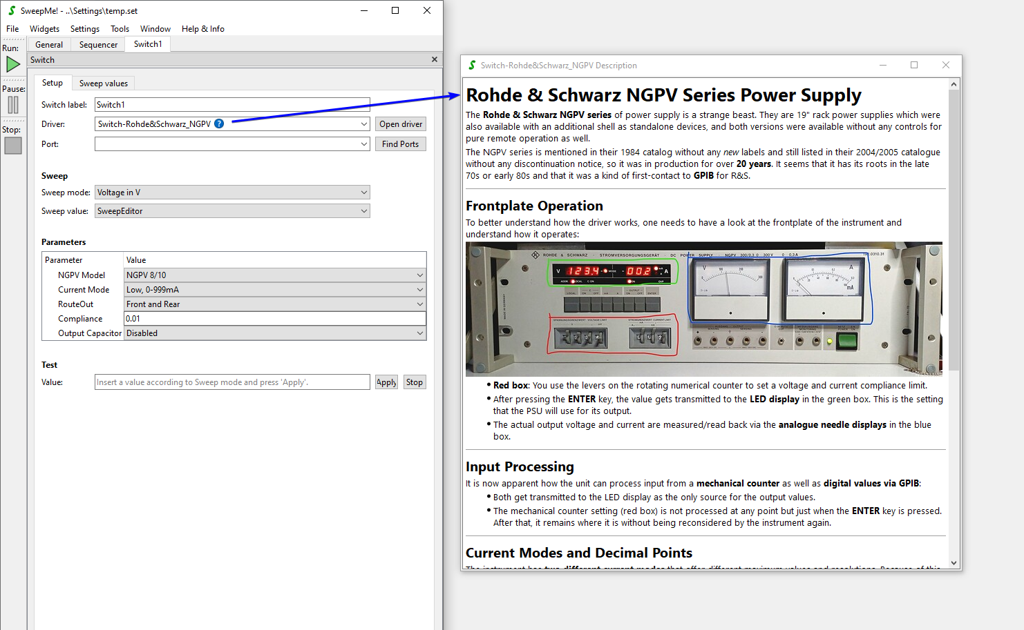

Drivers can now include a dedicated description file, making instructions and usage guidance more accessible to users directly within the software.
To provide documentation for a driver, include one of the following files in the driver directory:
  • doc/description.md (Markdown)
  • doc/description.html (HTML)
If a description file is present, SweepMe! displays a help icon next to the driver in the driver dropdown. Clicking this icon opens the documentation directly in the software, providing a more user-friendly experience than previous docstrings or inline comments. You can even reference images which you also put into the doc directory.
Even if a driver is not publicly available, adding a description is recommended to help future developers understand and maintain it. Full instructions are available in our wiki.
As an example, the Switch-Rohde&Schwarz_NGPV driver uses this new feature:
This driver was contributed by Christian, and it now includes a description accessible via the new help system. Version 2025-08-25 can be downloaded from the SweepMe! Version Manager or developers can view it in the GitHub repository.
