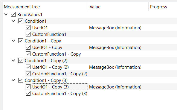

One way that comes to my mind is using the add-on module ReadValues to load an excel or csv file where you can define a list of image paths and you can add further columns to define parameters or whether a certain test should be done.
A sequencer could look like:
In this example, there are four branches who represent different tests to be done.
A Condition module in each branch is used to check whether the branch should be processed or not.
A UserIO module could be used to tell a user what do do in this step before the sub-routine starts that is represented in my example via a CustomFunction module.
The problem that you have to change the image in the widget Image is related to the fact that you can only select one variable, but you cannot change the variable later on. This is why the content of the selected variable must change which is done in the above example by using a ReadValues module that sweeps through a list of image paths and returns them when iterating through the rows.
