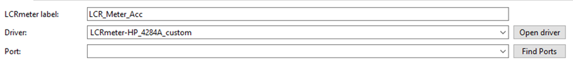

Unfortunately, about two weeks ago, we experienced a problem similar to the one BMTUB (Benjamin) had already described in November:
The GPIB ports were no longer listed within the GUI. Devices with a LAN connection, however, were still recognized.

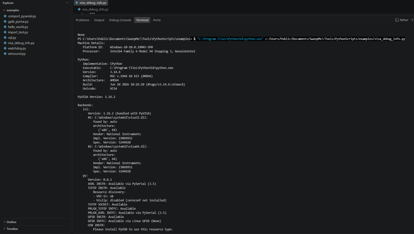

You wrote that you have used the script gpib_pyvisa.py
Did you run it in your own Python environment or did you run it with the Python Script Tool?
You can go to menu “Tools” → “Python script” to run these scripts within the Python environment of the SweepMe! executable:
Please test the scripts gpib_pyvisa.py and visa_debug_info.py.
If you run them, the output is shown in the Debug widget (key F2).
Can you send the output. It will be interesting to see which VISA runtime is detected and whether the script can find GPIB ports. You can also modify the script to show all VISA resources (not just GPIB).

Thank you very much for your quick response and the tip to run the script via your SweepMe Console!
It actually seems that the Python versions themselves differ between SweepMe and VS Code, where I had tested the scripts previously. Also the absolute path of the Executable is different as well as the Compiler.
As a result, the PyVisa version isn’t recognized in SweepMe.

SweepMe! comes with its own Python environment including a matching pyvisa version. So, it does not rely on your own Python or pyvisa installation.
The fact that the Pyvisa version is not shown in SweepMe! is expected. When pyvisa is shipped it with an executable, its version number is not correctly determined. It think this is because the version number is dynamically created that breaks in executables:
From the credits file of SweepMe! 1.5.8.8. it should be version 1.13.0.
Independent from the missing pyvisa version number, the script can find a visa32.dll file at C:\Windows\system32
which is the same path and file that you have in your Python 3.14 environment. That is already good.

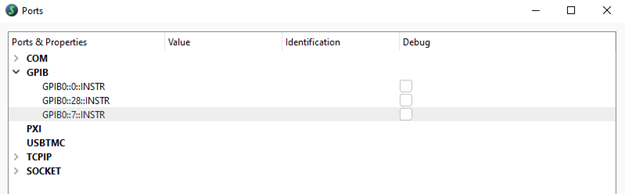

  • When go to “Tools” → “Port manager” → button “Find all ports”, do you see any debug message?

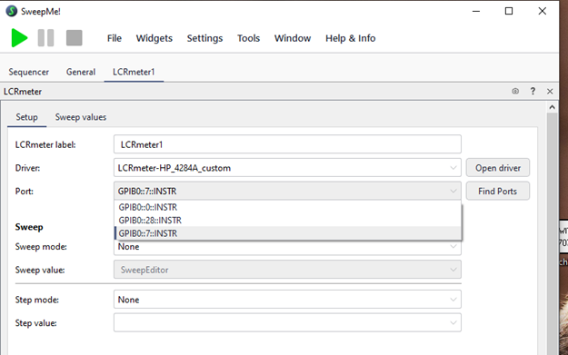

Installing the BETA version 1.6.1.2 has resolved the problem.

    • Noting happens at clicking
    • No debug message

    • LCR-Module was needed to reinstall
    • After doing this the test for LCR-Meter GPIB-Connection was working
    • Port manager now finds also all GPIB-ports
