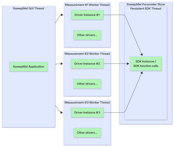

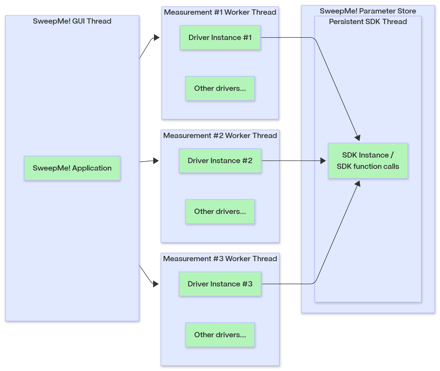

The overall architecture looks like this:
Graph definition
%%{init: {'theme': 'default', 'themeVariables': {
    'fontFamily': 'ZT Nature Medium',
    'clusterBkg': '#E0E9FF',
    'mainBkg': '#b3f4b9 '
flowchart LR
    subgraph GUI["SweepMe! GUI Thread"]
        direction TB
        s1["\n\n\n\n\n\n"]
        APP["SweepMe! Application"]
        s2["\n\n\n\n\n\n"]
        s1 --> APP
        APP --> s2
        style s1 fill:none,stroke:none
        style s2 fill:none,stroke:none
        linkStyle 0 stroke:none
        linkStyle 1 stroke:none
    end
    subgraph WT1["Measurement #1 Worker Thread"]
        D1["Driver Instance #1"]
        O1["Other drivers..."]
    end
    subgraph WT2["Measurement #2 Worker Thread"]
        D2["Driver Instance #2"]
        O2["Other drivers..."]
    end
    subgraph WT3["Measurement #3 Worker Thread"]
        D3["Driver Instance #3"]
        O3["Other drivers..."]
    end
    subgraph PS["SweepMe! Parameter Store"]
        subgraph SDKTHREAD["Persistent SDK Thread"]
            SDK["SDK Instance /\nSDK function calls"]
        end
    end
    GUI --> WT1
    GUI --> WT2
    GUI --> WT3
    D1 --> SDK
    D2 --> SDK
    D3 --> SDK
As far as the SDK is concerned, nothing ever changes.
