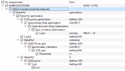

I have a tree (picture below):
-read_values module; “SAMPLE_POSITIONS”
(excel sheet; 64 rows in this case, where the last column has a 1/0 (true/false) value depending if it should be measured or not.)

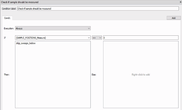

-condition module; “Check if sample should be measured”
(set to always, comparing the value from above with 0 and calling “skip_sweeps_below” if statement is true.)
-SMU / Spectrometer module to measure something
(Robot can be ignored, as the issue occurs even when the module is unchecked)
When I set only the first row to 1, it will still “measure” the other 63 rows even though it recognizes the value to be 0 and also skipping the actual measurement. (In the Parameter Widget the value can also be seen correctly) “measure” means the SMU will briefly turn on and the spectrometer makes a sound but no data is collected/saved.
When creating a new test setting with the tree described as above, the problem does not happen. We had similar problems before, where the condition would not work, where, however, just redoing the setting (full copy one by one) fixed the issue. Can this be an issue when updating SweepMe! while using “older” settings? The setting was created in 1.5.6 and there is no warning in the general tab. (We currently use SweepMe! Version 1.5.6.19)

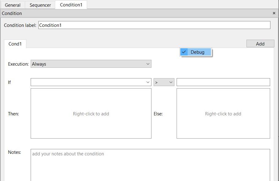

Something that I forgot to mention last time: Condition has a Debug mode that can be activated by right-clicking somewhere into the tab:
It was more a feature that we implemented for us to debug things, which is why it is a bit hidden, but can be used by everyone as well.
It will print out further infos to the Debug to see which data is compared, which type it has and whether it resulted in True or False.
Maybe you can see that way, whether the variable is evaluated too early or whether the parameter is not correct yet.
